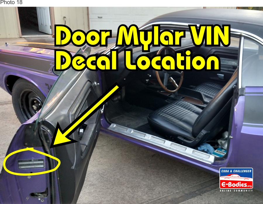

#9 DOOR MYLAR: The last and final VIN to check is the Door Mylar VIN data decal. This decal is located on the drivers door jam. See photo 18.

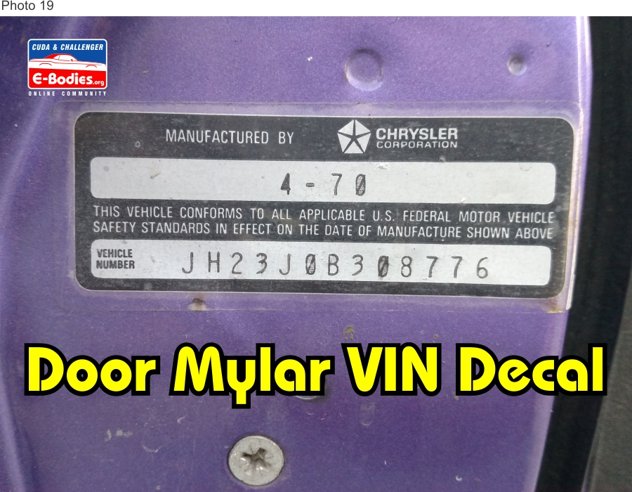

The Door Mylar data VIN decal is printed on a black and silver sticker and is tamperproof. So if you try to remove it the sticker comes apart and the VIN is no longer readable. But not to worry if your project does not have the original Door Mylar data VIN decal because a company called ECS Automotive Concepts reproduces fantastic replicas. For a reasonable price you can order a brand new (Chrysler approved and licensed) Door Mylar VIN decal. If you are looking at an original un-restored E-Body then the Door Mylar data VIN decal should be in place and match the Dash VIN. Check to see if it’s been painted over or taped off and painted around. All factory Door Mylar data VIN decals were placed on the vehicle after paint. From what we’ve seen the Hamtramck built E-Bodies had the Door Mylar data VIN decal installed horizontally and the LA built E-Bodies had them placed them vertically. Lots of repainted cars tape around this decal instead of replacing it. Photo 19 is of an original Door Mylar data VIN decal.

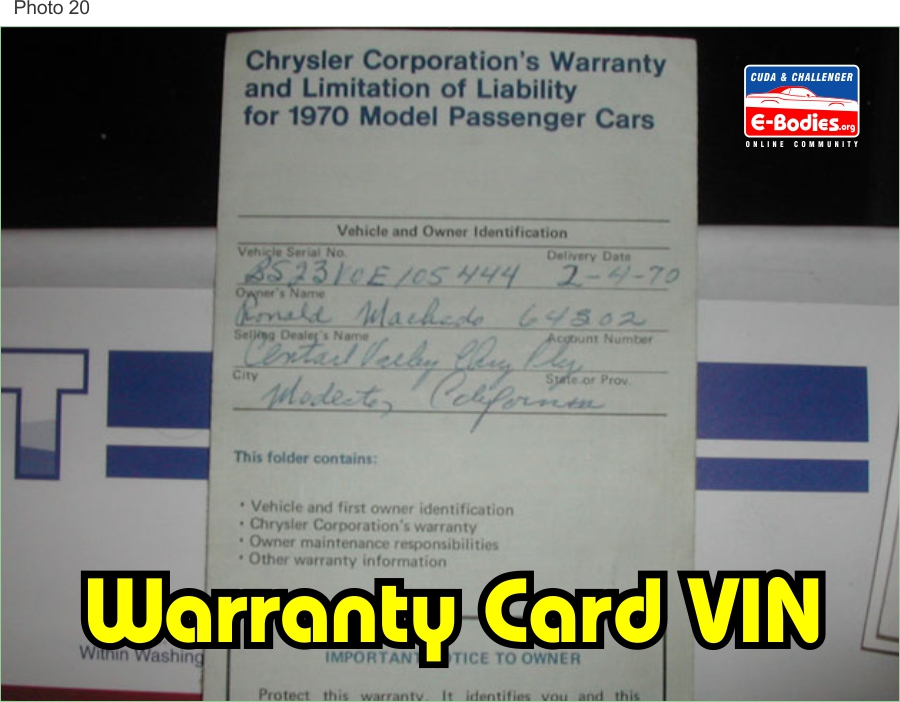

Bonus time! There’s a little known 11th VIN that very few people know about. That’s because it’s rare and not many cars are found with it. It’s the Warranty Card that was placed in the glove box. See Photo 20. The VIN is either hand written or typed on the Card. The Warranty Cards are reproduced by ECS Automotive Concepts.
