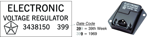

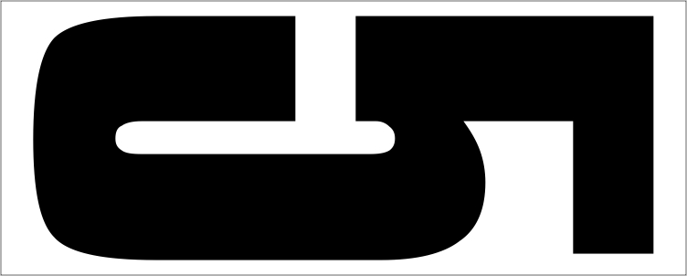

Voltage Regulator 1″ x 2″ (White Ink on the face of the Black Voltage Regulator)
Voltage Regulator Stamp Date 399 (39th Week 1969)
Voltage Regulator Stamp Date 439 (43rd Week 1969)
Voltage Regulator Stamp Date 469 (46th Week 1969)
Voltage Regulator Stamp Date 499 (49th Week 1969)
Voltage Regulator Stamp Date 090 (9th Week 1970)
Voltage Regulator Stamp Date 150 (15th Week 1970)
Voltage Regulator Stamp Date 220 (22nd Week 1970)
Voltage Regulator Stamp Date 310 (31st Week 1970)
Voltage Regulator Stamp Date 380 (38th Week 1970)
Voltage Regulator Stamp Date 470 (47th Week 1970)
Voltage Regulator Stamp Date 021 (2nd Week 1971)
Voltage Regulator Stamp Date 111 (11th Week 1971)
Voltage Regulator Stamp Date 211 (21st Week 1971)
Voltage Regulator Stamp Date 351 (35th Week 1971)

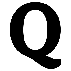

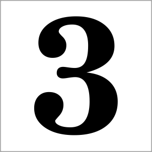

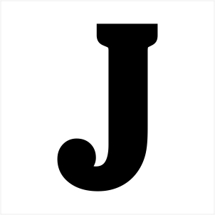

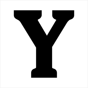

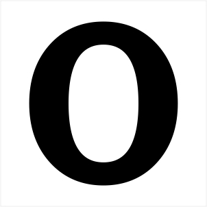

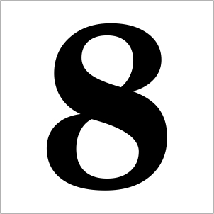

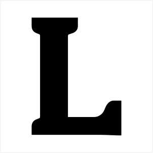

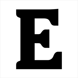

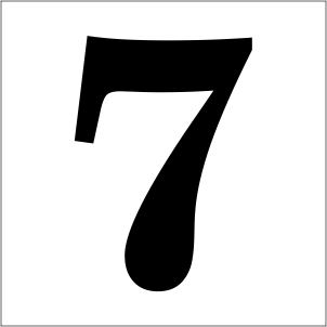

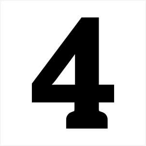

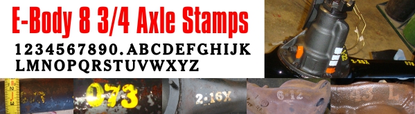

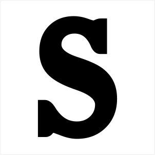

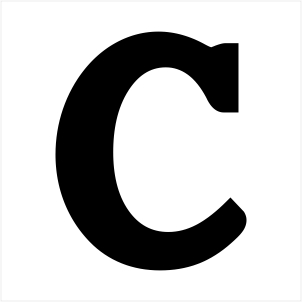

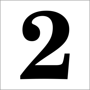

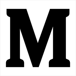

8 3/4 Axle Stamps 1″ x 1″(Normally found in White and or Yellow ink)
0 1 2 3 4 5 6 7 8 9 0 . –
A B C D E F G H I J K L M N O P Q R S T U V W X Y Z

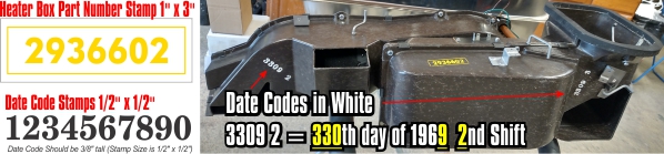

E-Body Heater Box Stamps
(Part Number is normally found in Yellow Ink and Date Codes in White Ink)
Heater Box Part Number Stamp 1″x 3″
Part Number “2936602” Stamp
Heater Box Date Code Stamp 1/2″ x 1/2″
0 1 2 3 4 5 6 7 8 (9 is the same as 6 only upside down)

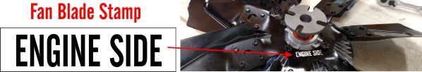

Mopar “Engine Side” Stamp 1/2″ x 2″
(Ink stamped on the Fan Blade in White on the side facing the Engine)
ENGINE SIDE
