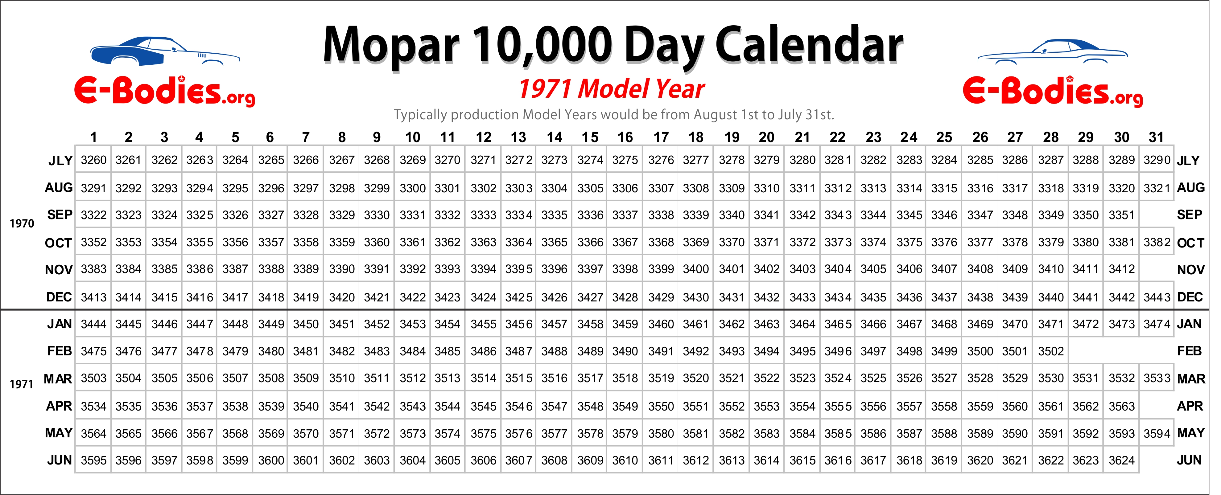

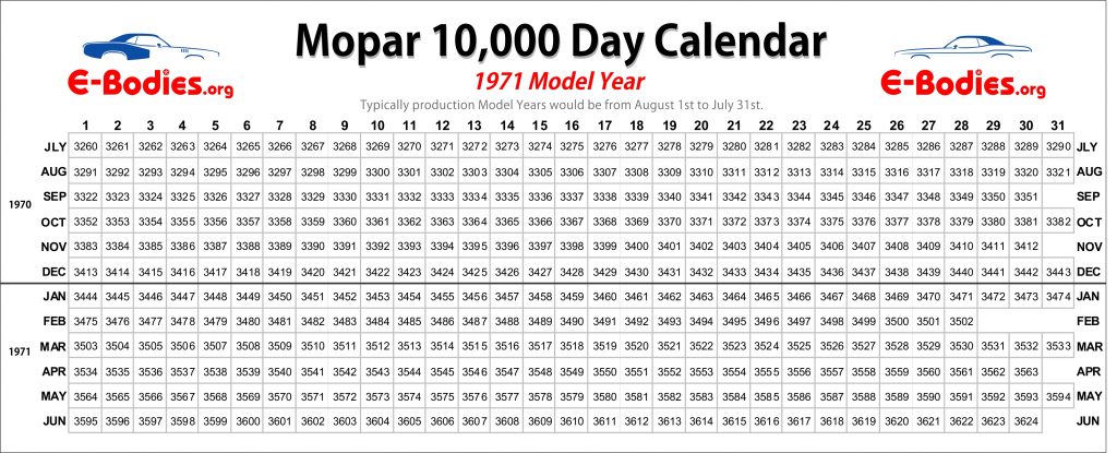

The Mopar 10,000 Day Calendar is a 4 digit stamped identification number on the Engine and Transmissions that informs you of the EXACT DATE it was assembled.
Typically production Model Years for Dodge & Plymouth would be from August 1st to July 31st.
