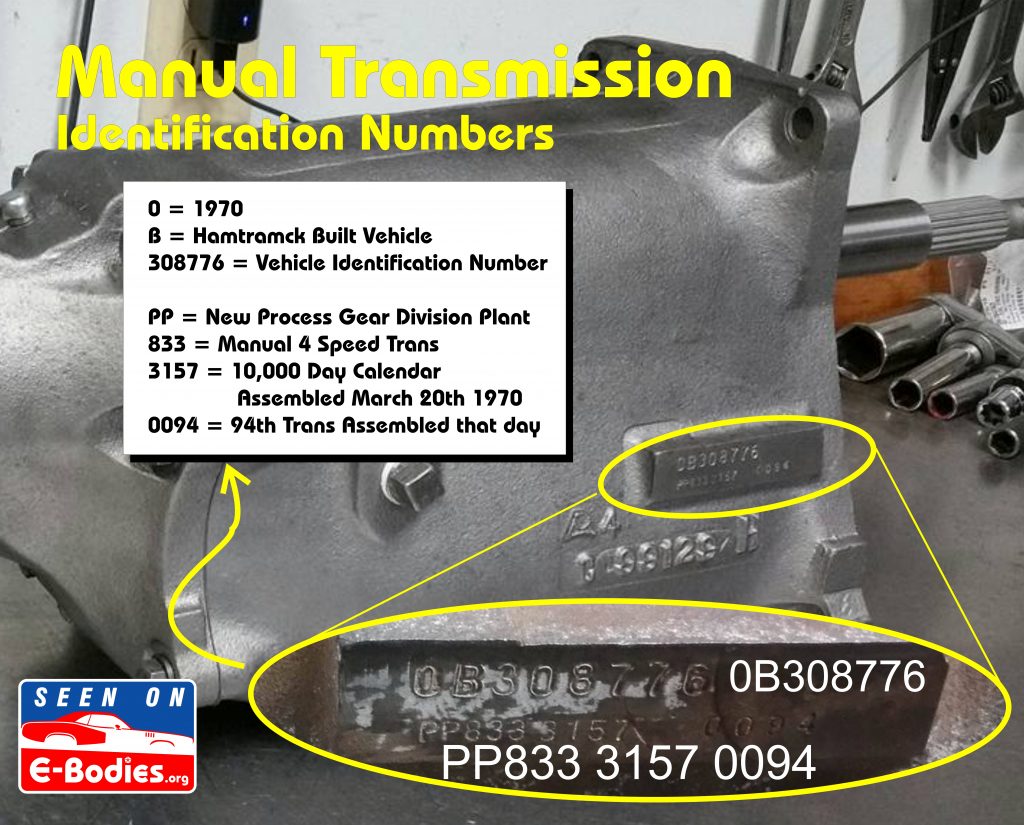

Dodge & Plymouth Engine / Transmission serial numbers and symbols decoder
1969 Model Year (2530 – 2894)
1970 Model Year (2895 – 3259)
1971 Model Year (3260 – 3624)
1972 Model Year (3625 – 3990)
1973 Model Year (3991 – 4355)
1974 Model Year (4356 – 4720)

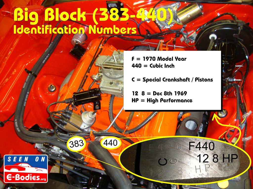

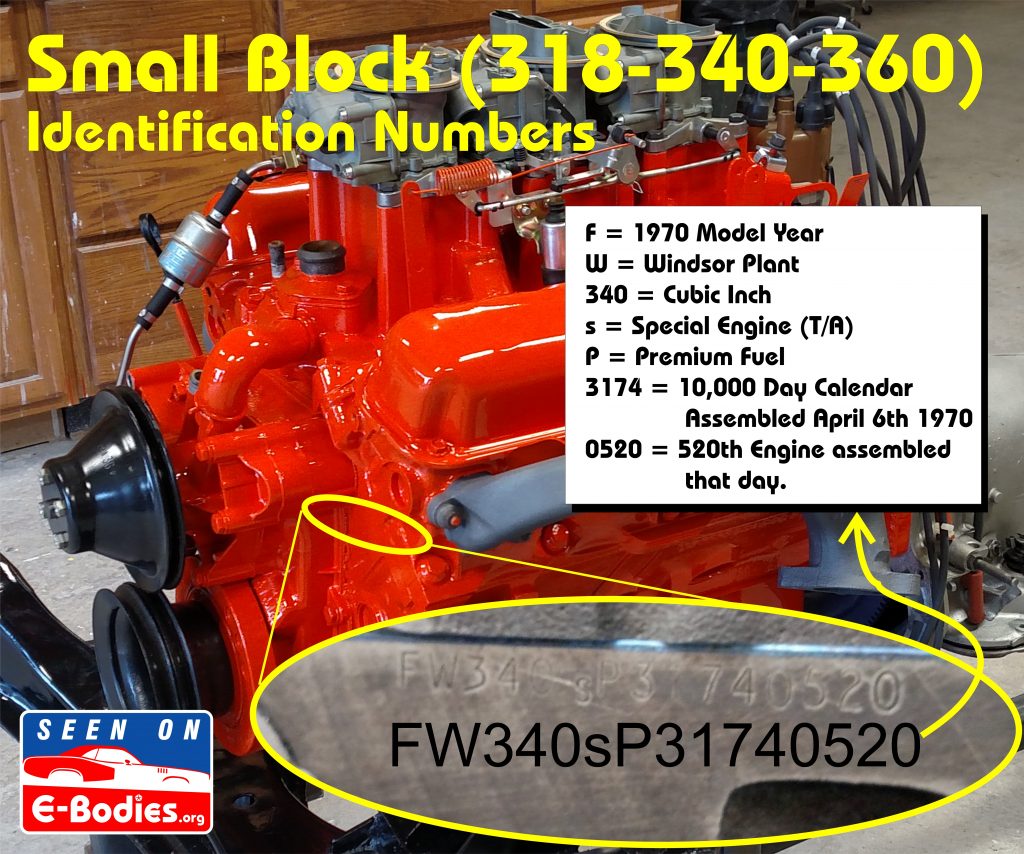

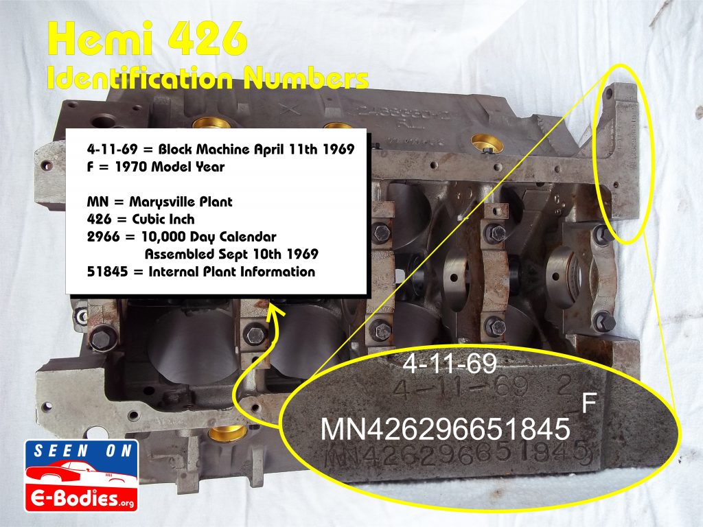

Engine Assembly Plant Codes:
M or PM= Mound Road, Detroit, Michigan Plant (318-340-360)
W = Windsor, Ontario Plant (318-340-360)
T or PT = Trenton, Michigan Plant (198-225-383-400-440)
MN, NM or MV = Marysville, Michigan Plant (426 Hemi)

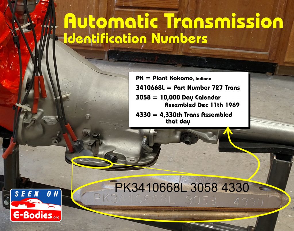

Transmission Assembly Plant Codes:
PK = Kokomo Plant, Indiana (Automatic Transmissions)
PP = New Process Gear Division, Syracuse NY (Manual Transmissions)

A = .020″ Oversized Cylinder Bore
B = .010″ Undersized Main & Rod Bearings (Oversized Bearings)
C = Special Crankshaft & Pistons
E = Cast Crankshaft
H = Standard 4 Barrel Carb
HP = High Performance
LC = Low Compression
OS = .005″ Oversized Valve Stems
P = Premium Fuel Recommended
S = Service Engine (found on Warranty Blocks)
sP = Special Engine use Premium Fuel (found on T/A 340 Engines)
WT or TW = Water Tested (normally found on Hemi’s & Warranty Blocks)
X = Oversized Valve Guides
2 = Second Shift
♦ = .008″ Oversized Tappets
✠ = .001″ Undersized Crankshaft Journals (Oversized Bearings)
✠+X = .010″ Undersized Crankshaft Journals
